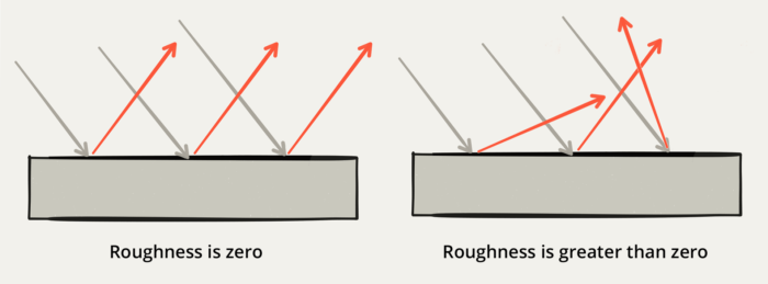

How Roughness Works
When roughness is set to zero, light simply bounces off that material at an inverse angle (like a mirror). When roughness is increased, light that reflects off that material scatters at varying angles, resulting in a more satin or matte finish.
Roughness breakdown
Setting Roughness in KeyShot
By increasing roughness, a surface will become less glossy and more matte. The same amount of light is being reflected from the surface, but adding roughness diffuses that light across the surface. A surface with little or no roughness concentrates the reflected light, giving us sharp reflections and highlights on a surface.
