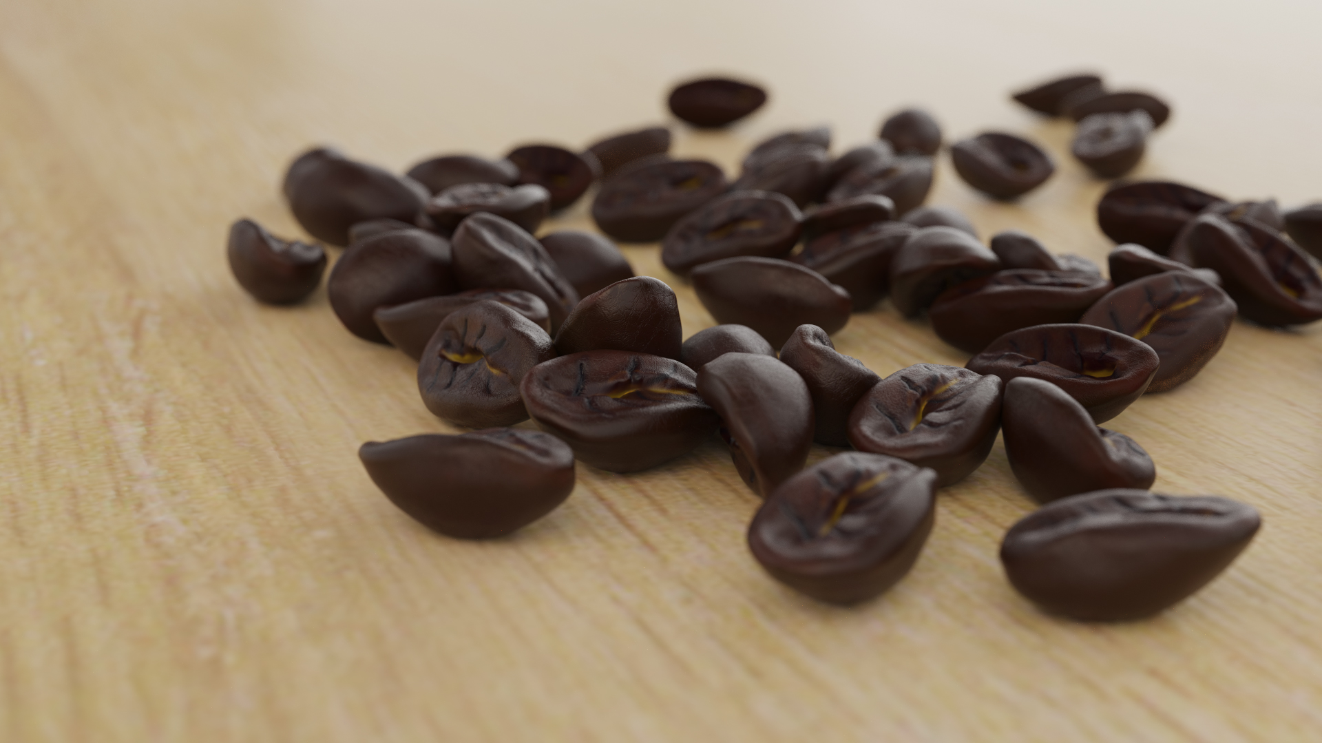

Move Tool – Settle, As Parts
As mentioned, by enabling As Parts, you tell KeyShot to settle a group of objects by its individual parts, rather than as a whole. This is incredibly useful when simulating something breaking apart or if you need to scatter many parts imported into KeyShot as one.
One note on Settle, As Parts. The Settle operation may take more time to complete. The amount of time is entirely dependent on the triangle count of the parts and will be longer when working with objects that break into many, many parts.
Whether its dropping items onto a desk, scattering coffee beans across a countertop, or creating unique stylized compositions, KeyShot Collision and Settle features will not only help you add a new level of realism but will also help you do it with speed.
