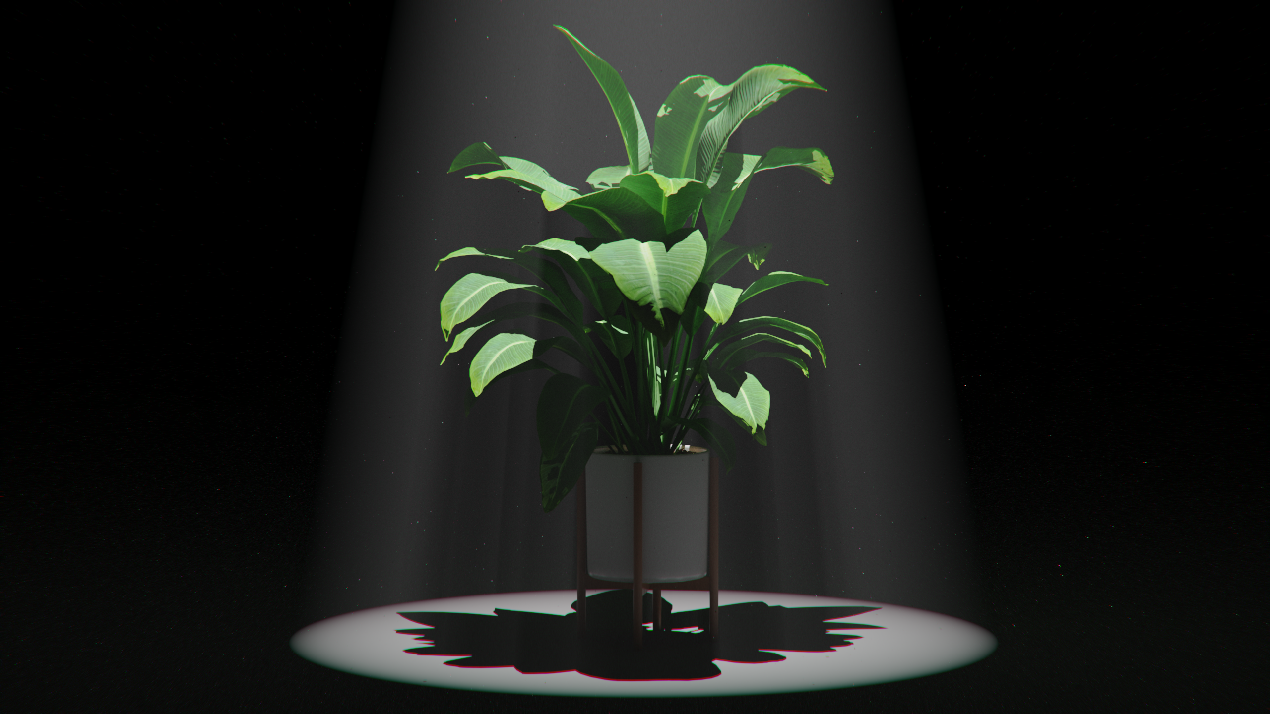

In our example scene, the house plant is isolated and prominent with no other details in the background. This is a great method for creating hero shots that illuminate your subject and call attention to details such as surface texture or material properties.
To create this type of composition, you’ll first want to place your subject in the center of your scene and add a Ground Plane (Edit, Add Geometry, Add Ground Plane or Ctrl+G) to give your subject a surface to sit on.

Next, add a Spotlight (Edit, Add Light, Spotlight or Shift+4) and move it above your object. Adjust the Spotlight parameters to your needs. (Note: If using KeyShot 9 or prior, you will need to first add a piece of geometry to your scene and then apply a Spotlight material from the Materials tab to create a physical spotlight.)

With your Scattering Medium now applied and your physical light in place, you’re now ready to finalize your composition. At this point, it’s all about adjusting both your Scattering Medium and Spotlight to create the look you’ve envisioned.
You can create stylized effects by adjusting the Spotlight or Scattering Medium’s Color and you can adjust the intensity of your fog-like effect by adjusting both the Scattering Medium Transparency Distance and Density.
This stage of your scene building comes down to creative expression and preference, so play with these settings until you’ve dialed in the appearance that best fits your needs.
