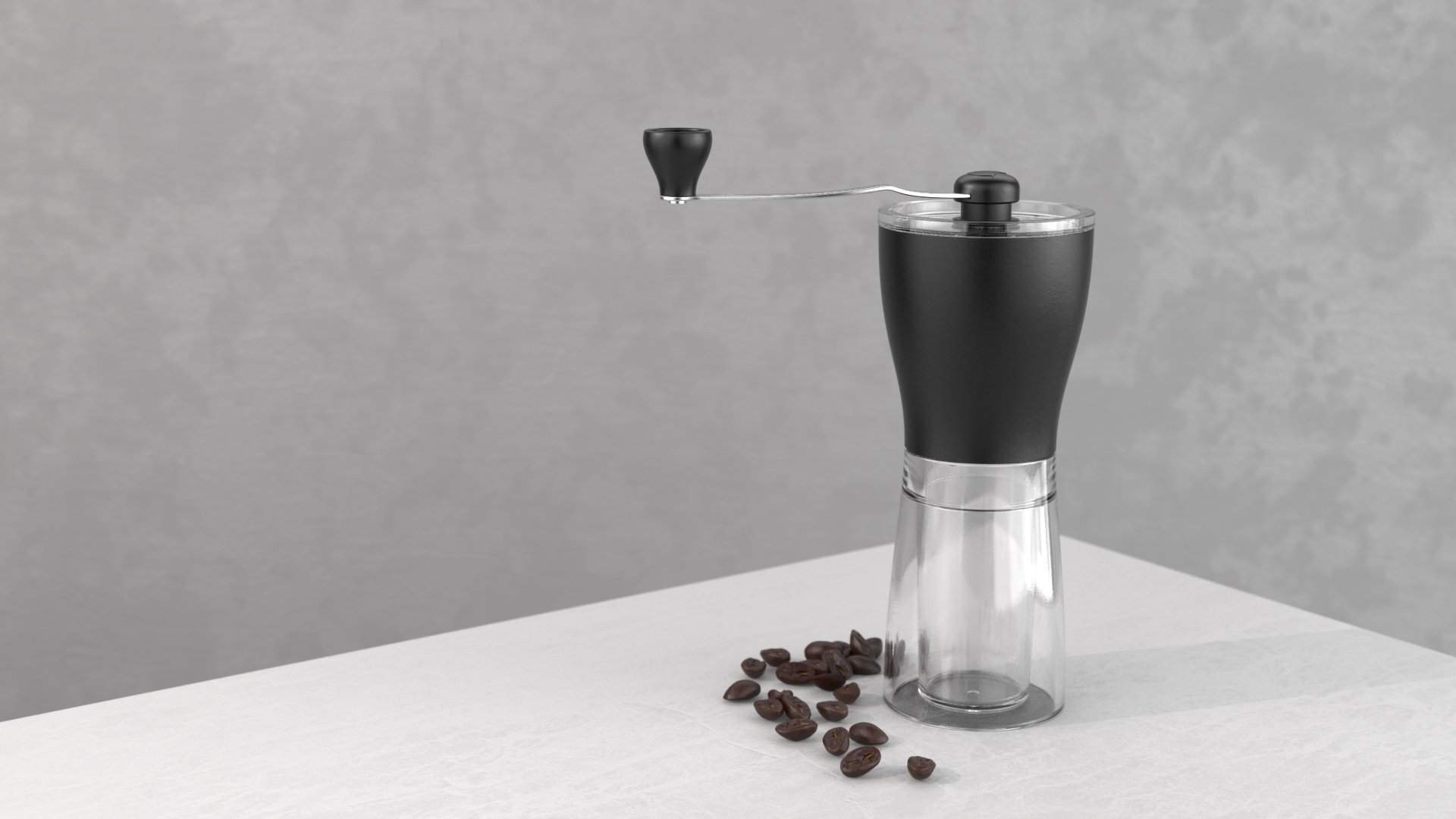

For an example, download the coffee grinder model from KeyShot Cloud. It contains the Material Graph setup shown in the video as described below and also includes Multi-Materials which demonstrate how you would setup colorway options.
Download Coffee Grinder
