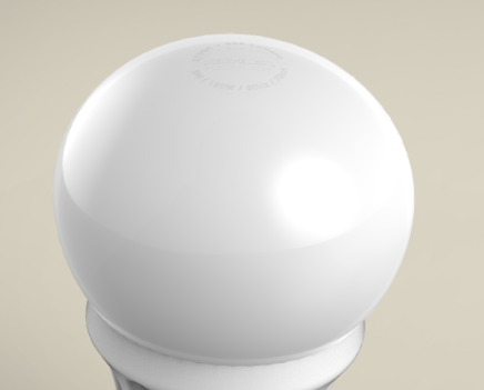

I have a dome on which I'd like to locate a logo on the very top center.  Can't seem to find a way to get it exact....
I'm sure I'm missing something.

What's the problem exactly - Are you having trouble getting the logo concentric with the dome? Would you be able to post a screenshot?

I attached the image.  It's a lamp diffuser that I'd like a screen printed logo on the top center of the dome..........
Any way to hit it right?

Chose camera top-view with as little perspective as possible ... maybe even add a plane trough the sphere and raise it as high as you can in the sphere .. it'll show you where the center is.  Then position the lable by clicking on the small circle that remains visible of the sphere.
